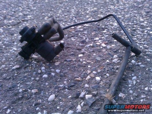

Hello all...
New to this forum, but not to others or trucks. Anyways, i'm replacing my 1999 5.9 with a 2001 5.9. Everything has gone smooth and it's all back together, except one thing. (Pictured below) If anyone can please let me know what it is and where it goes, it would be greatly appreciated. I can't find a picture of it in any manual. I don't have any open lines or electrical connectors, so i'm kind of at a loss here. There is one exactly like this one on my right fenderwell, but like i said, i can't seem to find where this one goes.

Looks like the purge selenoid for the gas tank vapor system. Should only be one per vehicle. My 2000 has one.
Don't toss it if it's functional...it's worth money to someone who needs one.
That's my guess too

I have one that looks like that if its the same thing. Mine is mounted just drivers side of engine center on the back end of the motor by the dizzy.

On my '00 that was on the passenger fender around the headlight area.
It is indeed a canister purge valve.

97's had them on the drivers side of the engine near the rear. That's where it was on my '97.

Looks like they were on the fuel rail up to 98, then moved to the fender for 99 and 00. Beyond that I'm not sure, but it looks like it was left on the engine when I bought it. So its just an extra part now.

its an evap purge solenoid that senses the puff sent from the fuel pump letting your computer know that all is well and theres no leaks

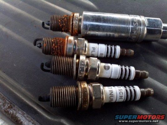

So i pulled the plugs and this is what i got
I also did a compression check on it, but here's where the problem lies. I didn't check the new engine for oil when i bought it and apparently it was full of oil. so i'm not sure if the oil had drained everywhere when i was installing it. Not even sure if that will make a difference or not. But when i did the compression check there was oil all over the end of the tester.

Cant see you plugs, pic wont show but by your video's I'd say check your timeing make sure your on there and then check fuel pressure. Because if you gota pump it that much just to start you have an issue some where. Unless your running an old chevy motor in that dodge =)~

Thanks... You should see the Plugs now.

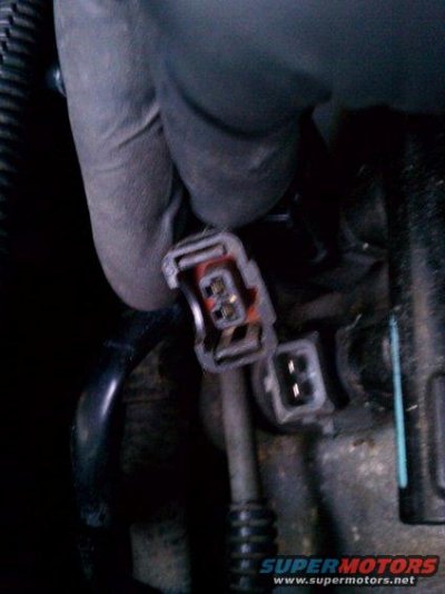

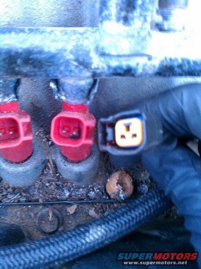

Yes... I'm getting volume and pressure at the fuel rail, but i still need to pull the infectors.
the engine i bought came with different injectors and the connection on them was different too. so i kept my old injectors which were new when i started this whole thing.
Will this make a difference?
old injectors and connections
new infectors and connections
