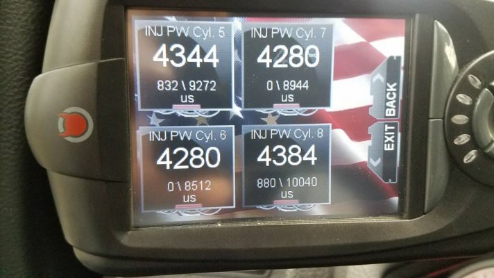

I decided to add all 8 Injector PW PIDs to my Trinity so I could see an approximation of fuel flow. injector PW measures how long the injector is opened for or "fires" for.

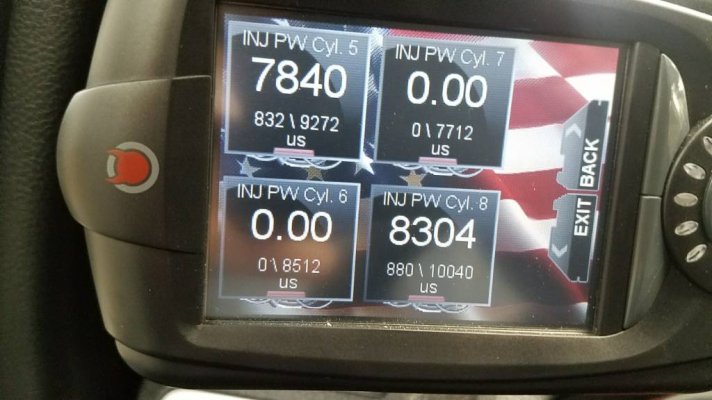

When the truck goes into MDS you can see the 4 cylinders shutting down which I was expecting. What I wasn't expecting was the 4 cylinders that are still active to essentially double the fuel output.
How does this save fuel if it just doubles the fuel into the 4 active cylinders?
MDS off
MDS on

The Eco light is somewhat more accurate because when the mpg goes to 99 when you're coasting down a hill all 8 injectors go to 0 so essentially the pcm is cutting fuel completely from the engine. Found that out by using these PIDs.
But that has nothing to do with MDS. It cuts the fuel even when in manual shift or tow/haul mode...

I was surprised to see that. One would assume that when it cuts the fuel to the MDS cylinders the fuel flow other 4 stay about the same. I mean thats how to save fuel. But we all know what they say about assuming....
