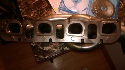

Good morning,
So last night I got my JBA shorty headers delivered. Ive never seen headers outside of the being bolted on but do these look right to you? The ports look shafty and just off, there were bought new and I may be wrong but the ports dont look right or even....please help!

Looks like JBA to me.... Just check them for flatness with a straight edge and as far as the ports its not always gonna be pretty making a round tube into a D shape. You can put the gasket on the header and mark the high spots and grind them down with a nose grinder or similar tool to match the gasket opening.

cool, ya they are flat just the ports looked off. Thank you!
