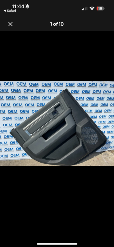

Wanting to get some different door panels for my ram and found some 2013 door panels on Facebook market place that are in good condition and for a decent price. Do the 2013 crew cab outer door panels fit a 2017 crew cab?

What do you mean by outer door panels ?
The sheet metal ?
behind this panel is the window glass

sorry for the confusion, I’m referring to these
Yes but the door switches are different electrically. You'll need to use the switches from the '17. I believe the electronics '16 and newer are all the same.
The door panels from '13 and newer should all be interchangeable.

The part in your picture is called a Door Panel or Door Card

Sheet metal, like in doors did not change hardly at all, but the electrical components, module & switch may have changed to a different Part #
If it's just the shell. You don't need to change over anything. You can use your current window switches
