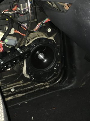

I went with Infinity REF-9623ix series with Metra 72-6514 adapters
Probably the best plug and play mod I've done. But the dash speakers made the biggest difference. Don't forget sound mat while you have the door panels off

I went with JBL Club series in my 2014 CC. They were a great upgrade and don’t need an amp: they sound great just off the head unit. I replaced the 3.5” dash speaker and all the 6x9’s in all 4 doors.

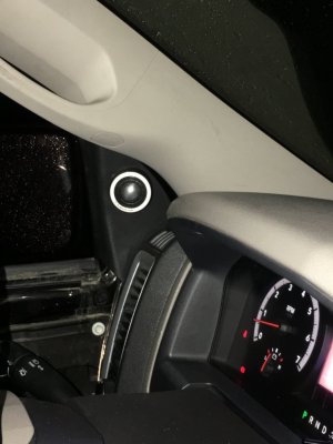

Running Rockford fosgate T2 6.5” components in doors, tweeters in sail panel, and infinity kappa perfect 3.5” midranges in dash. All speakers are amplified. Sounds amazing.
3.5” dash midranges are closer to 4”...and fit perfect as long as you cut off one of the mounts. I tried the JL audio 3.5” and wasn’t impressed at all. These infinity midranges are the best dash speakers as long as you amplify them.

If you look, look for drop in 6x9 components, then you keep 6x9 and add separate tweeter in pillar.
