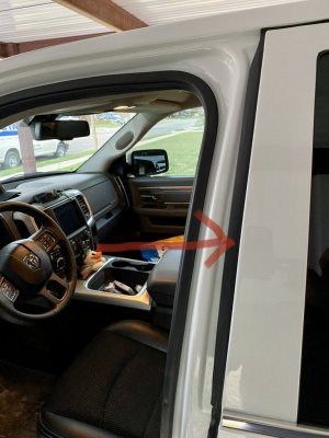

So the trim on the back doors always comes unseated from the door. Both passenger and driver. It doesn’t come completely off but lifts off of where it’s seated over the course of a week or so. I seat it, it unseats and repeat. Should I make an apt with the dealer or is this something I can take care of myself.

Mine does it too. Has since day one. I got some weather strip adhesive and squeesed a small bead in about a foot length in the crack and let it cure. I no longer have that issue.

Yep, same with my '17 1500, I just knock it back into place. I'm not bothering with the dealer, it will likely prove frustrating with no good resolution. If it bugs you that much I guess you could glue it.

Thanks for the info guys. I have never experienced this with my other rams but I won’t bother with the dealer if others are experiencing it. May try the adhesive if I get around to it.
