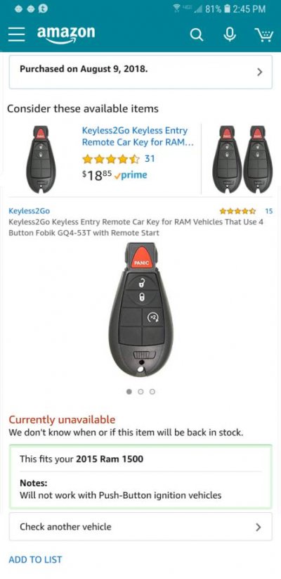

2nd: One of my key FOB stop working. It will lock/unlock doors but will not turn the ignition on. I believe at one time I got the FOB wet so I assume it is bad. What is the cheapest way of getting a new and Re- sync?

Not much help on the first one... As far as the key fob goes I ordered this one for mine. It looks like it's out of stock now, but I believe it was about $20. Had the dealership program the key. They charged another $50 for that. Because it was "aftermarket" they couldn't guarantee that it would program correctly, but had no problems at all. It was definitely cheaper than purchasing the OEM fob. Make sure if you order one you pay attention whether it's for remote start/no remote start or if you have a push button start you need a different model. Hope this helps 13ed4176027a58e84ee66c54f45340fe.jpg

I may try that rout first. Thanks Natec003 !!

Do you have to go to the dealership to get it programmed?
