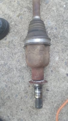

While you have it apart check the passenger side and grease the splines. It isn't serviceable without disassembly and my splines are seriously degraded and the cv is very sloppy. You may be able to save yours since it seems water intrusion is the biggest culprit. I need either a new front dif or will try to rebuild mine. 20200513_191047.jpg20200516_114809.jpg20200516_132433.jpg

While you have it apart check the passenger side and grease the splines. It isn't serviceable without disassembly and my splines are seriously degraded and the cv is very sloppy. You may be able to save yours since it seems water intrusion is the biggest culprit. I need either a new front dif or will try to rebuild mine. View attachment 209443View attachment 209444View attachment 209445
