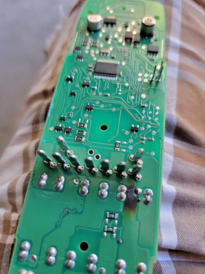

Pulled the board on the master switch panel to see if there was a visible issue with it. There's what appears to be a burn mark on the backside of the board. This seems to be in spot for the rear windows which function fine. Not sure its affecting this at all.20220605_150428.jpg
Now there's two dark circuit spots on the opposite side that look suspect. One is specifically at the lock side the other at the top of the board where the mirror switch. (Lock switch circuit at the bottom right)20220605_150751.jpg
Mirror switches at top in the above pic. They all function however. I'm not savvy with electronics but these spots seem off. I still can't make sense out of the aftermarket switch panels not operating the front windows. I just ordered a used OEM master switch panel. Hoping that works before I look into the door module.
