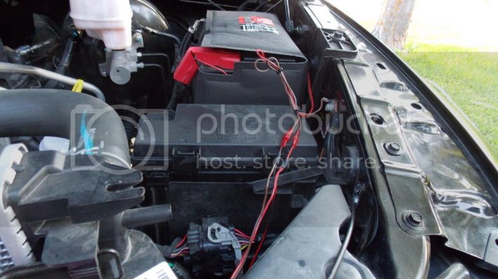

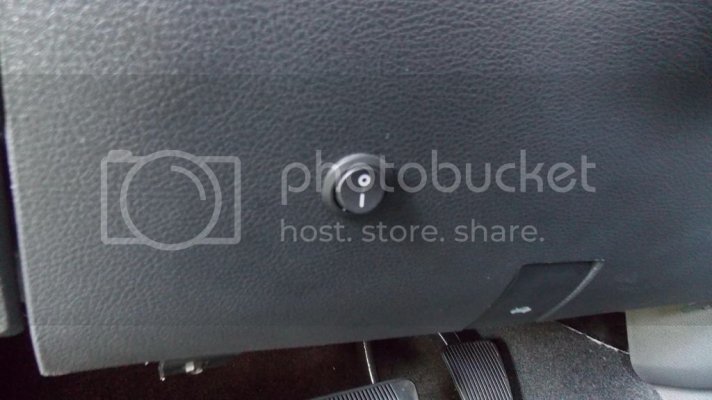

You don't have to bypass the DRL to wire in a switch. That is how I have my halos wired is to a physical switch I drilled and put in my dash.
