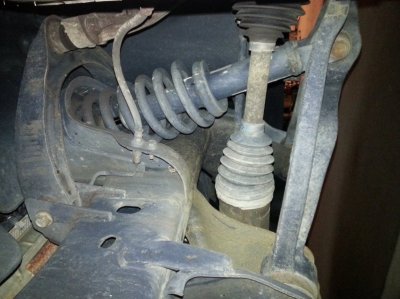

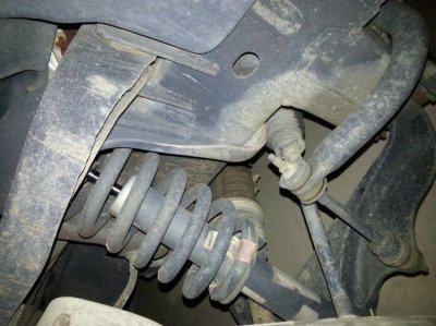

Here's my stock suspension. Correct me if I'm wrong, but I don't see any bump stops lol. But with the IFS there shouldn't be anything that would hit from lowering. Remember I'm new at this lol... Still learning

My bad you are 4x4 with IFS, that's a whole different setup. I thought we were talking about a 2wd. You need someone who knows the newer trucks. Sorry..

No big deal. Just looking at it, the spindle would provide better angle on the cv axle, but to me it looks like the coil would be what drops the truck. We'll see...

Spindles lowers by relocating the spindle 2" higher which physically lowers the truck by that amount. Altering spring height simply simulates an amount of suspension compression.

Ahh that makes sense. Thanks, couldn't find anywhere that explained that. I wish the spindles weren't so expensive :/

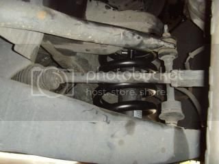

I bought the upper control arms thru Summit Racing. They were about $44 each, Moog replacements. Not a kit or part of a kit - but definitely a smart move. The new ones are more tubular designed than the stock ones and the ball joint was already pressed in place. I have a picture:
The new control arm and new coil are only dark black things in the photo - the things not covered in 50,000 miles of road grit :)
Awesome!:waytogo: Thanks! I just wanted to make sure there wasn't a kit. I saw a few guys talking about "raising" the upper ca's. I think that was for a bigger drop than just a spring drop.

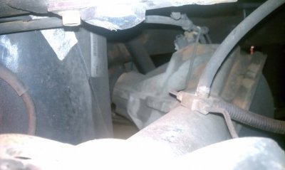

Weld it. I ran a full bead around the flip mount and havent had a problem
