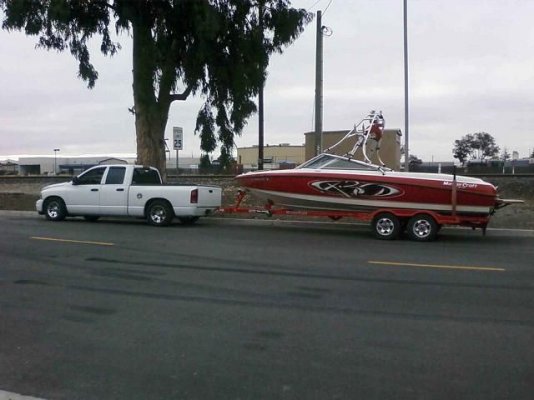

Purplewillie
Dec 7, 2013
6
2005
4 /6 drop 4x4 with helper bags
I also tow a 22.5' sport cuddy
