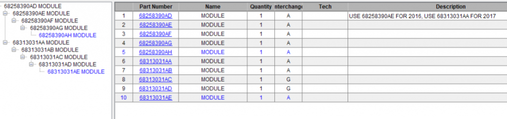

Benny,
I'm trying to see if a newer BCM retrofit into my Durango will fix some of the issues I have with my UAQ install. It seems like that's what the Ram guys have been doing, and I know at least 2015 Challenger guys are doing it too.
I know that most of those features work on a friends 2016, but there are 2 2016 BCM part numbers:
68313031AE (Claims fitment for the 2016-2017 Durango AND Grand Cherokee - all engine configs/trims)
and
68258390AH (Claims fitment for the 2016-2017 Durango, but only the 2016 Grand Cherokee - all engine configs/trims)
These two PN's don't supersede, and I can't figure out what might differ in terms of applications or any other reason they would be different. Can you see if there are any differences on your end? The parts website doesn't give enough info to be able to discern what is what.

Hi Phil,
I cant comment on cross compatibility as I have no experience with this.
What I did see is as you mentioned there was limited crossover for some reason but upon looking further into it Mopar has made a clear determination between the years now so I think that original info was not correct. See below
-Benny
