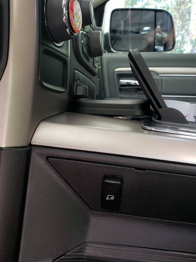

4dr Driver's Door Switch for 2016-18 & 19 classic :
68590220AA (single connector)
Replaced: 56046826AE
** 4dr Driver's Door Switch for 2016-18 & 19 classic:
68590591AA (single connector)
Replaced: 68319803AA
** (Has lighted power fold buttons - from 15-19 Grand Cherokee. Thanks @Killerb ): see Post 98.
4dr Driver's Door Switch for 2013-15 ? :
68620451AA (dual connector)
Replaced: 68110867AB
2dr Driver's Door Switch for 2013-15 (to 2018 apparently) ? :
68148895AB (dual connector)
2dr Driver's Door Switch for 16-18 ? :
xxxxxxxxx? (single connector)

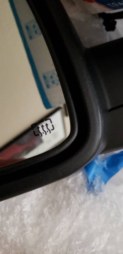

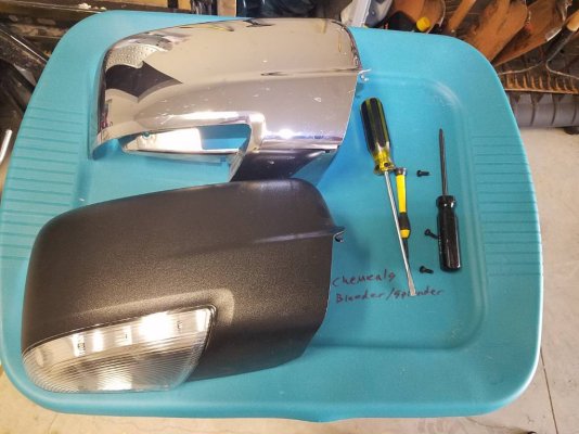

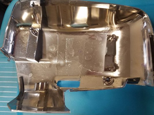

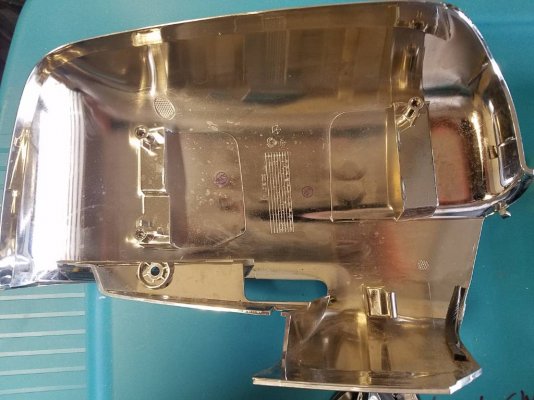

Regular Mirror, Glass Removal for chrome/colored housing swap
* I wanted to get rid of the chrome on my Laramie mirrors without losing memory functions and came across a set of Big Horn Power Fold mirror housings in Standard Molded Black plastic in the for sale section. I have no idea about PNs/ if they can be purchased seperately but these must have come from a 09-12 or a 13-18 truck but I'm not sure.
You will need to leave power on to tilt them down & inward so you can look behind them to know how they get removed.
If you break the glass ...
... (From AllMoparParts)...
68079362AA - passenger side Heated/Auto dim mirror glass ($200)
68079363AA - Driver side Heated/Auto dim mirror glass ($160)
Pictures & Mopar Disassembly PDF uploaded to Flickr....
Mopar - 18 Ram 1500 Mirror Glass Removal - TA.pdf.
My 2018 Mirror Housing Swap Picture Album.
Note:
The driver side and passenger mirror glass each attached differently on MY 18Ram1500 Laramie Chrome Capped Memory Mirrors (Verify you're own mirror style for each side to avoid damage) ....
- LH/Driver (used the Folding Mirror Glass directions):
Round mount on back of mirror glass required flat screwdriver in specific spot to pop it off.
- RH/Pass (used the Standard Mirror Glass directions):
Rectangular mount on back of mirror glass required pulling/tilting the mirror glass down from the top and pivoting on the bottom clips until they cleared.

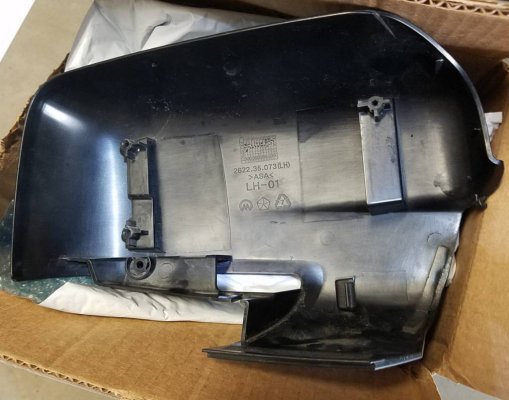

Mirror Cover PNs (Can't be purchased seperately / in diff. colors)...
No I am sorry the mirrors are only sold in complete assemblies (aside from glass) , The caps/covers are not servicable
-Benny
LH Standard Black Plastic Folding Mirror Cover: 2622.35.073
RH Standard Black Plastic Folding Mirror Cover: 2622.35.074
LH Chrome Plastic Folding Mirror Cover: 2622.35.071
RH Chrome Plastic Folding Mirror Cover: 2622.35.072

Before and after preview pictures:
12baa6dbb6482227840e778b43210bfb.jpg920e85b81e9e56cf95156fe54c283b45.jpgdbc34e05a88dd502f4a74fb9379afa8a.jpga8e613cbc83f4dfc69e545a7df303477.jpg

Can anyone confirm if the 13-18 Mopar Power Fold tow mirrors support AUTO Dimming?
& Any regular cab/2dr folks with power fold mirrors care to confirm their driver's door switch PN?
(2013-14 and 2016-18 may be different PNs)
Here what I have so far....
EDIT: sounds like Reg cab may all use the same switch...

Future Post 5
* I wanted to get rid of the chrome on my Laramie mirrors without losing memory functions and came across a set of Big Horn Power Fold mirror housings in Standard correct plastic in the for sale section. I have no idea about PNs/ if they can be purchased seperately but these meet have come from a 09-12 or a 13-18 truck but I'm not sure.
Note:
The driver side and passenger mirror glass each attached differently on my 18Ram1500 Laramie Chrome Capped Memory Mirrors.
Pictures & Mopar Disassembly PDF coming as soon as I get the chance.
Rtn to Post 1.

Ricks Ram
May 1, 2015
4,411
3,416
My question is how do you know if the Mirror is auto dim. I’ve been searching and no one actually has auto dim on any of the mirrors. I was looking at getting power fold paint match mirrors but can’t seem to find out if the are auto dim or not
These are the pictures of a auto dim mirror and a non auto dim. You can tell instantly by the black plastic trim ring on the actual mirror glass. These are both power fold mirrors off of a 2019 Classic. The drivers side mirror(the one with the mirror heat icon) is the first one and is auto dim the second picture is the passenger side non auto dim. You can clearly see that the auto dim mirror has s much thicker black plastic trim ring on the actual mirror glass than the non auto dim.938f2a654c8cfe218e50cdb8a55ae2f0.jpge8326cf68149988d39bbd00cb64ab794.jpg

Mirrors came off of a 2019 Bighorn Classic. Standard mirrors textured black
DRIVER'S SIDE
Part# 68338373AE
Power Fold (Auto Dim),Blinker/Puddle Light,Non Memory
PASSENGER'S SIDE
Part# 68263849AI
Power Fold, (Non Auto Dim),Blinker/Puddle Light. Non Memory.
The part# for the Standard PASSENGER SIDE regular black textured mirror WITH (Auto Dim) is
Part# 68231240AC
Power Fold,(Auto Dim),Blinker/Puddle Light, Non Memory mirror
