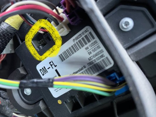

Hi!
I need to replace on of my mirrors and I was considering getting two mirrors with the lights. My existing are heated and power-not power fold (2015 tradesman quad cab)
I attached a photo of my module and I see that there is an unused port…I’m hopeful that will allow the new signal/puddle lights (after programming). Does anyone know if that is the case?
I don’t need the power fold and don’t really feel like spending the dough on the improved modules…so if this won’t work, I’ll just buy what works with what I’ve got
Thanks a bunch!

Hi!
Thanks a bunch!
Yes, they will be plug and play BUT you do need something like AlfaOBD to make some changes in the BCM so the lights work. I recently did it on my 2014.

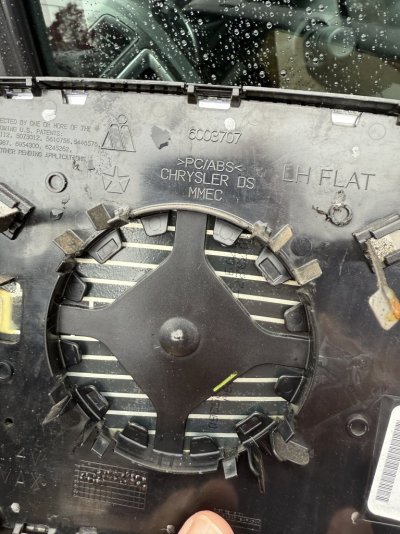

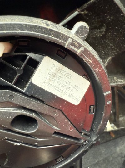

I need to ask a question about just replacing the mirror glass. I have a 2019 Ram 1500 Classic Bighorn, want to just replace the mirror glass on drivers side. Heated, power ( not auto) auto dim. I can not find a glass that will work. The back of the glass is a circle not square. Please if you know tell me where to get a replacement
I ran into something similar swapping the mirror covers on my 18 Laramie... One side has the square mount and the other side has the round glass mount.
Some Google/eBay search and I believe this may be the glass you're looking for...
PN: 68381787AA ... eBay link
OEM FACTORY NEW LEFT SIDE DRIVER SIDE EXTERIOR REAR VIEW MIRROR GLASS.
(Appears to have both heated & AutoDim connections)
** You should really reach out to RamForum Vendor @AllMoparParts.com & they (Benny) can verify it for your truck and get you one, check availability, etc. he may even have a discount for forum members he can offer.

I ran into something similar swapping the mirror covers on my 18 Laramie... I've side has the square mount and the other side has the round glass mount.
Looks like the one. Thanks. Yes I did pm Benny
