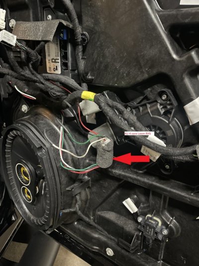

Managed to spend some time on it today and my issue is now solved.
I looked at the original mirror loom for the RHS and noticed there was a difference in the wiring for the AU loom.
So I copied the differences into the loom for the Laramie mirror and presto it is now working.
For the RHS turn signal to work I connected the green wire to C2 pin 9 and the black wire to C2 pin 10, leaving the white wire not connected.
Pics below of the AU loom I am referring to for those that might be interested.

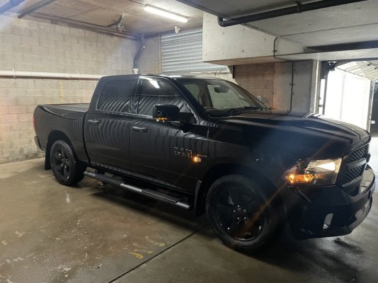

And this is what it looks like with the indicators on.
The indicators lights are from amazon with sequential led and puddle lights.
The mirror covers are from Ebay cause I didn't like the chrome covers plus they were a bit scratched.

Cool. Well done. So the wire change forced the indicators on the guards to work? Will have to look into it. My mirrors work but not the guard lamps.
I agree on teh black car the black covers probably look better. Min is white and the chrome probably suits it more, photos here:
