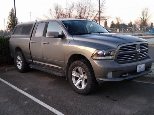

305 55r20 load range E. They are just over 33" diameter and a foot wide.
Bilsteins set to 2.1 in the front and a 1" Daystar spacer in the rear.
