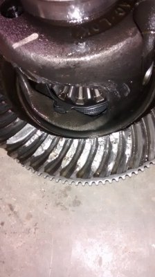

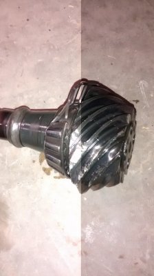

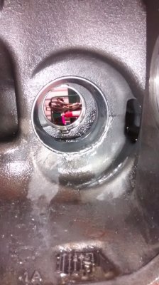

Well here's an update. I'm getting a whole new rear end, carrier with the limited slip, case, whole nine yards. The tech went to clean up the old case and found a crack, so in with the new parts. Here's some pics. Then there was a surprise sitting on the showroom floor. I didn't expect to see one of these locally.

I hope your luck turns around soon, but it is certainly lucky you were going slow when it locked up. I replaced my rear pinion seal a few weeks ago, and my nut was good, but I do not like the procedure to re-tighten the nut. No set value, just try to match the old torque which to me was really hard to measure because of the crap in lb. torque wrench I have. So, it ended up at 120 ft lbs for the pinion nut. Now I worry all of the time it is going to let go...Things WILL get better man.
