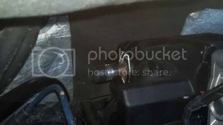

The 10 you save will prob be added back in for shipping and handling. Here is my setup
This is what I did for the rear port. Cut the line and put a rubber cap over it with a clamp. You will not really see it just looking in the bay unless your looking for it.

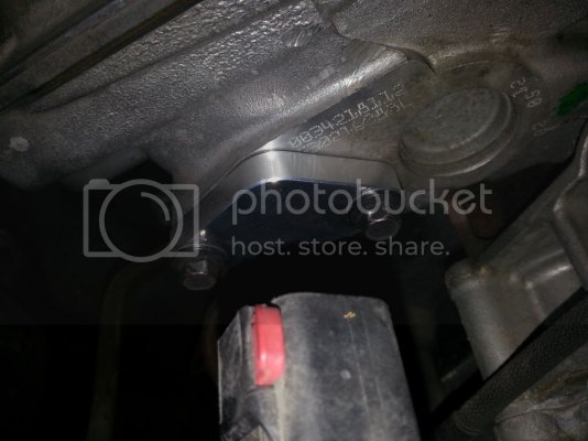

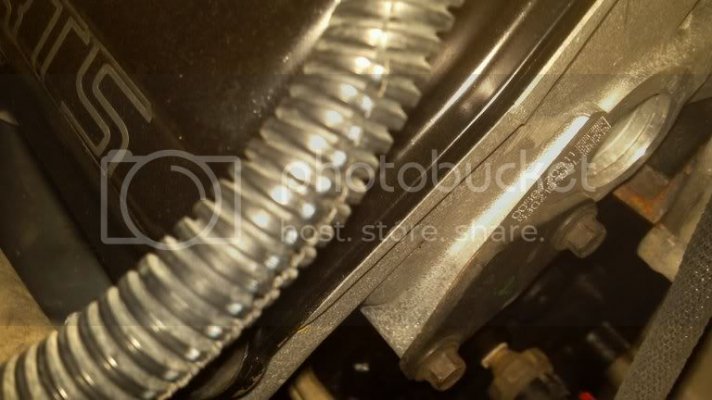

One more question an I'm done, is the block off plate listed on moes just the plate or is there a plug for the intake?

the billet one I got from Moes had the plate and plug. I'll snap a pic tomorrow morning.

sorry completely forgot about the pictures. here they are
the plug on the intake.
the block off plate
I apologize for the dirty engine bay.
