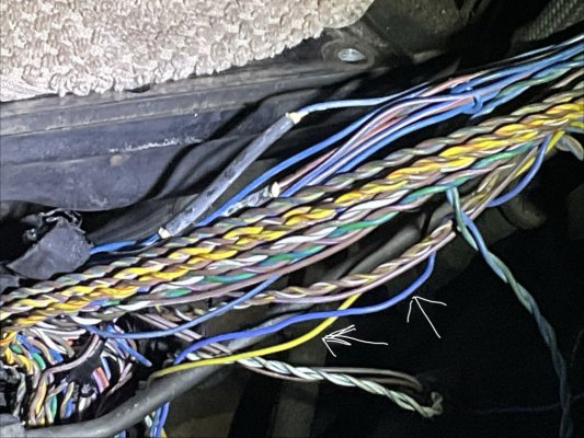

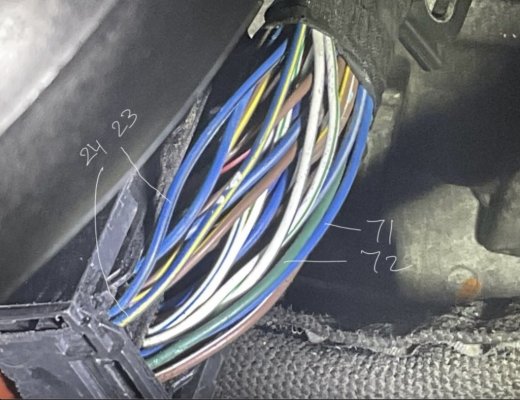

IMG_2966.jpegToday I’ve another truck P0489 I marked Blue and Yellow cables which is going to EGR pin 4 and pin 5, it comes ECM pin 24 and pin 23. Completely new cable installed with this weather I spend 3 days freezing now but I did it again. I put OEM STYLE terminal, crimping and adhesive heat shrink. No codes done.
If you have any questions guys I will help you ask me also maybe I can answer little late I will try.IMG_3045.jpeg
