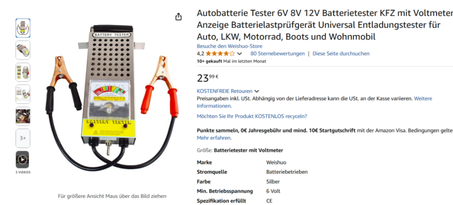

After another 8 hours the voltage was reduced from 12.79 to 12.77, seems normal?
That sounds great but the definitive test is to use a toaster-style battery load tester like the device shown above.
Then, there's no guessing.
They're very inexpensive in the USA ($18) and still cost effective in Canada at about 60% more than the US.

I found and ordered exactly the same device on Amazon Germany, it's not expensive and it doesn't hurt to have it
Bravo!
I've had a couple of these devices for many years. They don't get used too often, but they are invaluable to have available whenever there's a question about battery performance.
Like this one:

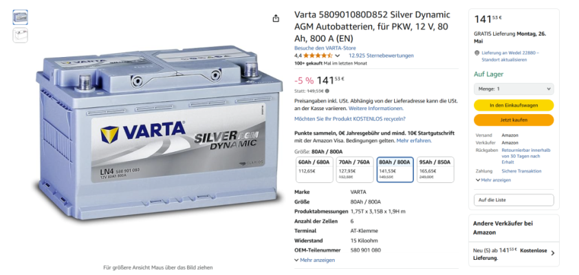

From what I can see, with your temperatures ranging from about 0°C to 23°C (32°F to 73°F), that looks like a good size, provided there aren't many aftermarket add-ons that draw current after the engine is shut off. Or, you haven't installed any high-power audio equipment.
An important feature of a battery is the warranty. I've seen up to 5 years for a full reimbursement, but typically, we see 3 years full coverage and then a sliding pro-rated scale after the 3 years for AGM batteries.
Another consideration for batteries is commute distance and the frequency of use. Intermittent use or frequent short distances will not lead to a long life.
For those situations, a battery maintainer or a low-current charger in the engine bay like this will help promote a longer life.
