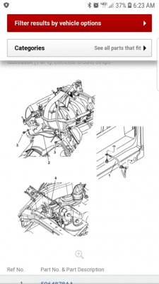

Googled it and got this. You could easily check this by using jumper cables. Just use one cable from battery negative to clean bolt on cab or fire wall.Screenshot_20210209-062323_Chrome.jpg

Thank you! I will check using jumper cables. I will be back with a status update.
