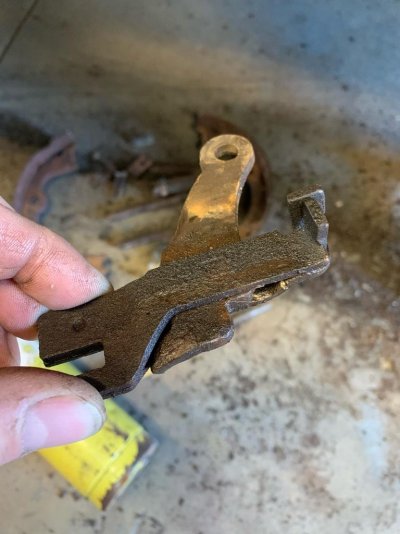

Please find the person that designed the E-Brake setup on this 2014 Ram 1500 I have and punch them in the eye...
Seriously, can we not invest just a bit of ingenuity or technology to make this thing work?
First the cable setup is a joke. Only one cable/side actually pulls on tight. Then the lever and pivot points in this disc/drum setup is painfully designed. Looks like they just grabbed some dude off the street that was drunk and said can you smack this metal with a chunk of wood and make a ****-Poor lever to rust solid so these brakes will never work right?
Does anyone know if there is an upgrade available or maybe a setup from another generation or vehicle that would improve this?
Especially given the electronic auto on this 8 speed, I would like to have a solid E-brake. I also park off camber a lot for hiking and hunting.
Thanks for reading and enjoying my vent... if you know of an improvement let me know.ef6240200c971bf4708e037b1bcda2c4.jpg

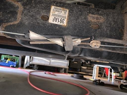

My cable hangs so low, I have installed an ibolt to route the drooping cable through for pure aesthetics.
Same here, in that pic I took I actually had it pulled up with the pedal. It hangs below the bottom of the frame! Heck there’s so much slack you lose half the pedal just in that slop....

Now that I’m thinking about it and I have all this free time maybe I’ll disassemble mine and give it a good cleaning and a grease job. Any recommended grease to do this job? I have green heavy duty trailer grease, marine grade grease, and red and tacky. Also have moly grease but I know that’s more for rubber and poly bushings and ball joints.

I don’t disagree on maintenance, I’m a big proponent, but since I just bought this 2 months ago used I of course couldn’t have maintained it. The design is simple, but it could easily be improved to reduce the chance of failure. I work in the maintenance industry, and I can tell you designing out failure is much more affordable and safer than routine maintenance. There is no reason with increases in technology and materials that this cannot be improved.
That said, I have found nothing other than stock replacements so I will be cleaning and lubing the assembly and replacing the levers. I service twice a year so it shouldn’t be a problem moving forward, but the cable design is just horrible. Hangs down too low and not enough bracing to ensure both wheels brakes are applied evenly.

If the cable is hanging that low it’s likely stretched over time. See if there’s any adjustment left in it. If there’s not enough might be an idea to replace the cables.

So riddle me this, for anyone who sees this. Look at the cable pic from my first post, and explain how both cables on this ebrake setup are supposed to be pulled at the same time when you push the pedal down.

It's just a parking brake so it doesn't matter if they come on at exactly the same time.As long as they both lock up.Probably one side locks and then the other cable has to move(catches up) and locks the other side.I doubt any set-ups pull both cables at exactly the same time.
Actually it’s doesn’t matter if it’s at the same time, but it matters a lot that both have some minimum amount of applied pressure to ensure the axle/wheels can hold the vehicle. And most setups I have worked on over the years split and pull both from a splitter. This one pulls the passenger almost to the point of bottoming out and then the driver slightly moves. The driver has no means for leverage to be applied other than a chance that the cable is stiff enough when adjusted precisely to have the passenger bottom out and then the cable friction, not actual tension, pulls slightly on the driver.
I’ve been working on vehicles for 30 years. There are a multitude of better designs out there. I’m just venting and hoping they do better on other models and newer years. I like my Mopars but also like vehicles in general. I expect more from them than the average person.
