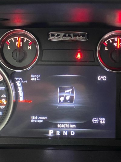

Hey everyone, first post!
Hoping to get some clarity on a couple issues that I’m having here.
I recently upgraded to the RA2 and premium cluster. I was able to get the mileage to update on the cluster but cannot foe the life of me update the idle and total engine hours. It just fails and then acts like it is not connected to the truck.
I also don’t know if there’s something I need to enable to have the audio show on the new cluster. It only shows “Audio” and a blank music symbol.

I got my odometer to work with my phone but had to use the computer verison to do my hours. Common issue.
No other steps/changes needed for the cluster upgrade.

Interesting, I only used the windows version. Not sure what the difference would be.
Any insight on the audio issue?

I’m not 100% certain but I don’t think it is suppose to show any album artwork or information in the cluster.

I think the cluster only shows radio channels? I only stream Bluetooth from my phone and all it ever says in the cluster is "Bluetooth"
