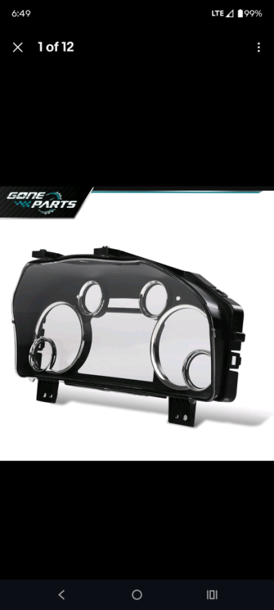

Hi all,
Is anyone able to verify if the lens and mask from the 3.5 gauge cluster will fit on a 7 inch cluster? I got a 7 inch cluster and was going to swap out this weekend and set the odo, engine hours, idle hours with alphaobd, but the lens on the 7 inch is pretty scratched up. The 3.5 in my truck is flawless. I was going to swap them out if they're the same. Mopar is backordered until late April on new lens/mask assemblies.
Thank you!
SitKneelBend
Moderator
Member Relations Specialist
Jan 8, 2015
10,977
7,668
St. Louis
3.6 Pentastar
Oh crap, i didn't even think the gauge faces were attached to the mask. I'm an idiot :banghead:
Yep, not compatible. The gauge face is the "mask" part of that part number. They used to be relatively cheap though (I think I paid $80 shipped brand new).
