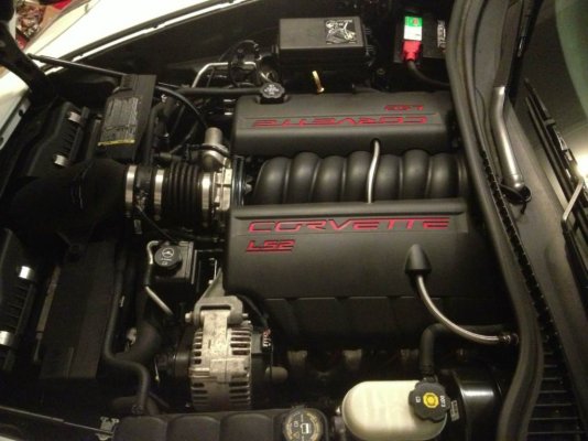

I took one of our cars by the car wash last week and was very happy with how it turned out. I know you may or may not get the same results at your local car wash. All I did was spray it with the rinse to get it wet, sprayed the tire/engine cleaner on it, sprayed with high pressure soap, then rinsed it off. I don't have it a before picture, but it worked extremely well.

Did you cover the alternator with anything? Especially with the high pressure soaping? The alternator has always been my major concern but secondarily other connections too and has kept me from opening the hood at the car wash on any vehicle I've ever owned.

No, I just avoided spraying the alternator directly.
