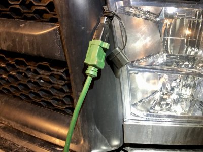

@U&A - Hey brother. I’m brand new to the forum. I came across your block heater instal here through an exhaustive online search for 6.4 block heater info. I have a 2016 Power Wagon with a 6.4. I also live at 9,000 feet in the Colorado Rockies. When I leave for work at 5:30 in the morning, it’s routinely well below zero here. My starter would howl and squeal when I would start my truck in the winter up here. It always started, but it made me cringe every time. Thanks to your link for the parts and detailed instructions, I no longer have that problem. I installed my block heater in about a half hour, thanks to your instructions too. I actually opened an account here just to thank you. My 6.4 purrs like a kitten now when I start it up - even under the nastiest of weather conditions.
So, a big thanks to you U&A!!9EAE3E09-F626-43C4-9CE2-41BD3D3C4E2E.jpeg47AA7CBB-7611-4A0A-9C5A-29AB1B6FA4CC.jpeg8668F660-8081-4421-9F51-6D71A1EE2A53.jpeg
So, a big thanks to you U&A!!View attachment 197004View attachment 197006View attachment 197008
This is EXACTLY why i did this thread!! To help others[emoji847]
I very pleased that this helped you sir.[emoji1303][emoji1303][emoji41]

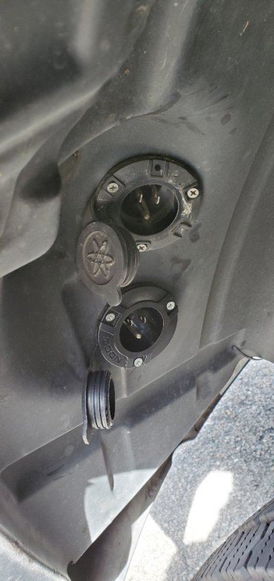

Big thanks to @U&A for making this thread! After waiting a couple weeks for the kit, I finally put mine in this morning. I thought since my truck is 7 years old rust would be a problem on the block where the heater goes into but it really wasn't too bad. Getting the starter out and getting the angle right to put the heater in was the worst part for me. I have Shorty headers and the collector flange is just enough of a different shape than the manifolds that it made it slightly harder to get the heater in the block. Other than that it went smooth.
Then I ran the wire up to the front fender liner where I have my battery maintainer plug mounted. Now in the winter I can power both.
Thanks again @U&A [emoji106][emoji106]1b1a71d65ad705a787c4f305bc9688d1.jpg38bc816c95789604823ca5039984f228.jpg
