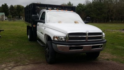

so this morning I started the truck as normal walk back into the house and then there's smoke coming out of the engine bay. Needless to say it was too late after I finally got the garden hose and put the fire out. pretty much anything in the engine bay is toast. Windshield pop, top of the dash burned and a little of the headliner. I'm not too concerned about the interior as much as I am about the engine bay. My question is what donor trucks and years should I be looking for to be able to replace practically everything in the engine bay. my truck is a 2002 Dodge Ram 3500 with the 5.9 L Magnum V8, manual transmission. There are lots of 1500 pickups around but I'm assuming those parts would not be the same, harness, relay boxes etc. truck was on liability insurance since it's been paid off years ago. and going and buying a brand new one like this is not an option for my business. Any help is greatly appreciated

Sorry to see that... I'm wondering if it might be easier to graft your bed/dually setup onto another 1 ton. maybe find one with rear end damage even cheaper. I'm afraid that while it could be done, it's gonna be a TON of work to repair that truck and not cheap.
That engine bay is a complete write-off. There will be nothing outside the block that's salvageable (if even that), not to mention brakes, steering & suspension, electrical/wiring, vacuum system, heating/HVAC, bodywork... ouch.

^this, it would be the easiest and cheapest way to do it, there’s plenty of wrecked 3500, just need to find one that was a rear wreck, even if it wasn’t a cab n chassis setup, the cabs and motors are the same.

Yeah been searching, just have more 1500 then anything. Most of the fire or heat was concentrated up top before it was put out, no hvac system to begin with so no worries, and paint and body are not a concerned. As far as engine its a gas not a Cummins so it can't set me back much. My primary concern is finding all the wiring and which years would be best near 2002, 97 98 99 00 etc which could best matching for this 3500. I assume a 2500 would be the same? As long as the truck has a 5.9 wont most components all be the same? Thanks

I'd say you're looking for a 3500 with the same wheelbase and mounting your gear onto it. Do some measurements. That box you have on the back may fit any truck with a long enough frame. It may be that a regular cab longbox dually of any year or make for that matter could fit with a little bit of welding vs the huge amount of work and potential unforseen issues you may have going the other route.
