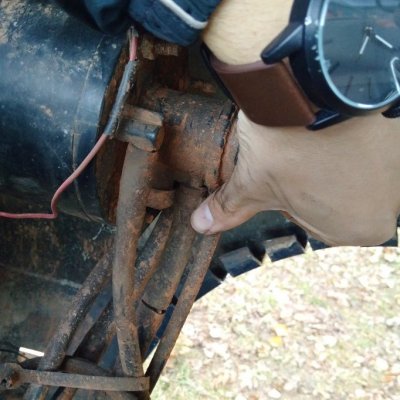

Update: I noticed my alternator belt was fluttering when the engine was running, so I tightened it by raising the alternator as much as I could. I do notice though that the belt still squeaks even though it's tight now. It's also a new belt. Why would it still be squeaking?... should I clean the pullies that it's on? Or is it a more complex problem like a weak alternator or something....
Also, found this hose disconnected sitting by my carb. One end is connected to the cylinder shaped piece that all the vaccuum lines run to, but cannot figure out where the other end belongs.
Anyway, I symptoms I described I my first post ^ makes me think that my timing Is off. The timing chain is quite worn but mechanic set the timing ahead to compensate, but that was over a year ago, so it could have worn even more now. Do you think it needs to be set ahead again? Or am I way off.

Look on the backside base of the carb, there should be a T connection for that hose. That might be your vacuum leak that was causing trouble before.
