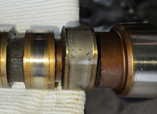

I can't believe I'm having to get a 3rd engine in my truck....
June 2023, truck was running rough down the freeway especially under load, after spending a day in a local shop where it was towed to, it was determined that the lifter was hardly moving on cylinder #3, the cam had flattened out so I made the decision to install a reman LKQ engine because it had the best warranty. (4 years / unlimited mileage)
During the past year and half, the engine had multiple leaks that needed attention and repairs, all under warranty. Oil pan gasket was leaking, then 4 months later the timing cover had a leak, another 2 months and exhaust manifold bolts needed to be replaced and driver side exhaust manifold needed to be replaced, then most recently a oil pressure sending unit threw a code and had it replaced. Again, all under warranty..
Fast forward to 1 week ago (June 2025) and the replacement LKQ engine has only 70K miles on it. Climbing a small hill (with no trailer in tow) and check engine light starts blinking (typically means an misfire) and the engine is running rough like a misfire. Drive it over the summit and another 5 miles to an exit where I can park the truck and call AAA to have it towed to the same shop the LKQ engine was installed about an hour and 30 mins away. They have now had my truck since Tuesday and just today said that it looks like the intake valve seat and possible lifter/cam is having an issue on cylinder 3. It's a like a bad dream that never ends.
Should now by tomorrow what the decision will be to either replace the engine AGAIN, or replace the valve train components, however if there is metal in the oil and on the cylinder heads, they need to replace it with another engine.
I'm extremely **** about oil changes and really taking care of my truck, never race it around, always on top of maintenance items, stored inside the garage, I tow a 7x14 enclosed trailer for business but never more than 3500-4000 lbs about 4-6 times a month. 95% all local driving, 85% highway driving, never sitting in idle for very long at all.
Needless to say, once this is repaired I'm selling my truck and buying a diesel truck. There are so many people dealing with this same issue, it's truly mind boggling.

My failed lifter was number 3 as well, but to be fair, the other cam lobes were not great.

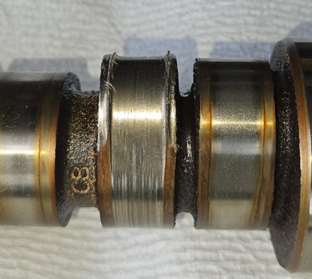

All ram 1500 Hemi's from 2005 to current, have MDS, which is a complicated system to drop 4 cylinders in cruise.
The Hemi's all rely on "splash" at idle to lube the lifters.
If you have any oil leaks, it doesn't take much of a low level to make the rollers blow on these lifters. Then the cam takes the hit. And so on and so on.
My oil level slowly got low, and I kept adding oil every now and then. Not that often because it was a very slow leak.
If you sit at idle a lot, and you are low on the oil dip stick, the lifters are not getting enough lube from the lack of splash. I live in south Florida, and sit with the ac on for long periods of time.
The torque requirements on the lifters are very low and confusing, not to mention a wet area with no lock nuts under the bolts. Mine had a few loose bolts as I spun the engine over and over to re-torque them. (thus making my Hemi tick go away) I added lock washers too, and slightly over torqued, which the book doesn't call for.
After tons of research, I decided to put an MDS delete kit in. My cam, starting with #3, had worn the lobe due to lifter failure, A few others had also started to go.
Best decision ever!
I also found out, Dodge knows about this problem, but to recall all of the engines from 2005 up, would bankrupt them.
This is my experience. I now love my truck. Faster than ever without MDS and the new cam.

this is interesting because just this week we took the valve cover off a 2018 5.7 8speed 330000km and guess what number 3 no movement
why would number 3 specifically get less oil than the others?
the customer didn't want to go any farther he had just bought the truck last week and was bringing it back
it was clear to me when doing the spark plugs the first day that someone had been searching in there! 4 out of 8 locking tabs were broken on the coil packs. some of the coil packs connecters were physically damaged. amateurs lol
drivers side had all the same age ngk spark plugs
pass side had a mix of new and old ngk along with some middle aged autolites lol wtf

Was #5 for me. 201k miles.
But #8 had both lobes starting to wear. The 2nd and 4th cam lobe in the very back group.
Is it just me or is it mostly the non-mds lifters that fail?
