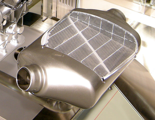

A P2002 code indicates that the diesel particulate filter (DPF) efficiency is below the threshold.
One thing that you might try:
  • Run the engine
    In a safe setting, bring the engine to 1,400 RPMs for up to 20 minutes. This should create enough heat to burn off any soot that's clogging the filter.
    https://www.obd-codes.com/p2002 ............ this is a good reference site
  • The DPF - diesel particulate filter - is in the shape of a catalytic converter and positioned in the exhaust system. Inside is a matrix of compounds coating the passages such as cordierite, silicon carbide and metal fibers. It's 98% effective at eliminating soot.
  • Cutaway photo of a diesel particulate filter (DPF)
    Read more at: https://www.obd-codes.com/p2002
    Copyright OBD-Codes.com
  • Run the engine
A great find. Thank you for the information. I've never had the truck in limp mode (a symptom). I've never noticed any fuel economy reduction (a symptom). (Who would notice a difference between 13.5 and 11 or 12MPG unless the reduction is significantly more than a few MPG. I average probably 13-14MPG.
