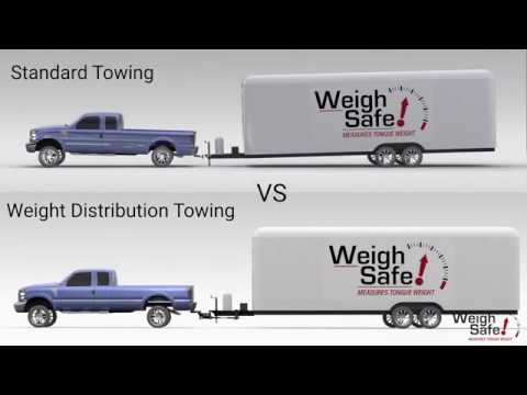

Sadly even being within spec for towing and having the WDH adjusted correctly the nose of these truck will still point at the stars, that not a problem if your just towing during daylight hours. If you try to crank the bars down enough to level the truck the rear end goes light which causes stability issues.
You don't know how a weight distribution hitch works.
PLEASE stop posting misinformation.
Watch this:
Riccochet
Aug 14, 2013
2,127
2,357
Somewhere around Charlotte
2020 2500 Laramie Longhorn
Watch this:
A WDH transfers weight from the drive axle back to the trailer axle and steer axle via leverage of the torsion/tension bars. Or tension chains if you use an Andersen. This doesn't prevent sag. For instance, lets say your tongue weight is 1000 lbs. WDH may transfer 300 lbs off of the drive axle. You are still going to deal with 700 lbs of sag plus the weight of the WDH, cargo and passengers. The best you can hope for is a level truck when hooked up. But level now means you are about 3-4 degree off from stock. That effects your headlight alignment. That doesn't negate the fact that leverage also comes in to play in the reverse sense that when you go over a dip or hump in the road you are compressing and releasing tension on the spring bars. When all that weight comes back down on the rear suspension it's going to compress more, and then spring back more. Creating that porpoising effect.
It's not rocket surgery to understand that the Ram 1500 has a soft rear suspension due to the coil springs. This has been known since the truck was introduced with rear coils. This is what gives it a superior unloaded ride quality over GM, Ford that use leaf springs. Maintenance has nothing to do with it. A brand new 1500 off the lot is going to sag and bounce with a load on the drive axle. I've owned and towed all over the southeast with 2 new 1500's from 2013 to 2021. It's why I now tow my 31' 8000# travel trailer with a 2500.
Ram 1500 is a great truck, and they tow ok'ish when stock. No way in heck I'd be towing 10,000 lbs with one even if it's rated for it.

So you post a video that backs what I just stated? (golf clap)
I know how they work along with the physics that make them work along with how to adjust for the load. There's no misinformation, if anything I set many people on the correct path to properly setting up a 1500 to push the towing spec right up to the proverbially "line in the sand"
