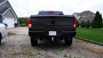

Can we get a shot of the back of the truck showing both tips and well pretty much what id see if I was following you thanks.
Sure, probably be tomorrow afternoon before I can take some. Unless I have some on the other camera.

Thanks looks nice

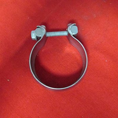

Had also to get the part 4578916AB (tips clamps) because the bolts were completely rotten. This part is not sold separatly for our truck since they soldered the clamp to the tailpipe extension and you need to get the entire unit $$$. The actual clamp was in good shape so I only replace the bolt.

Here's the final product

Looks good, Sticks out a bit more then I d want.

Looks good!! I think if I do mine, I will toss a set of turn downs that are flush with the bumper.
That's an option I'm seriously looking at.
It does stick out too much, so the other option is to try to have it shorten so it can be flush with the bumper.
Being in Montreal... I'm sure you would rather just replace he bumper instead of the bumper and exhaust.. Haha
