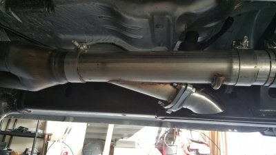

idk if you kept your stock hardware, but this looks rather simplistic?

Cutouts make it louder. It’s an adapter to open up before the exhaust. When you close it, goes back through the exhaust.
My opinion, F em. I have the same exhaust at my apartment. Pretty sure the Neighbour that lives on the other side of the wall of my garage hates me when I back in.
