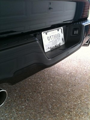

I was hanging out with one of my friends last night and he has a 09 trx4. Well he removed the exhaust from the muffler back and it sounds amazing so I'm probably gonna do that. Just have one question though, he has the standard side exit exhaust but I have the duals out the back so I was wondering if anybody knew how to mount the tips without pipes?

This is just temporary until I choose on an exhaust option
he has cutouts in the bumper for exhaust tips. :D
Yeah I have the bumper with two slots for tips so trying to find out how to mount the tips since no sports came with the side exit exhaust :/

Get an exhaust shop to run the straight pipes for you. There will be some popping and odd sounds at shift so just be prepaired, best think for ya to do is put an elec cutout on the truck that you can open and close when ya want to.

I went to a local muffler shop and had them cut just the stock muffler off of my 2011. They welded in a "single in dual out" 40 series Flowmaster in place of the stock muffler. I had them leave the rest of the stock piping including the resos.....personally I think it sounds great.
Basically it was just a muffler swap everthing else stayed.
