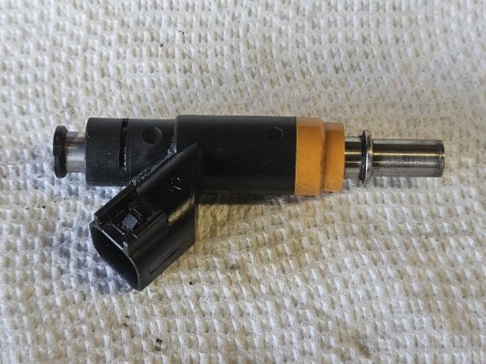

My injectors were rather cruddy at 201k miles, but cleaned up nicely.
Before:
After:

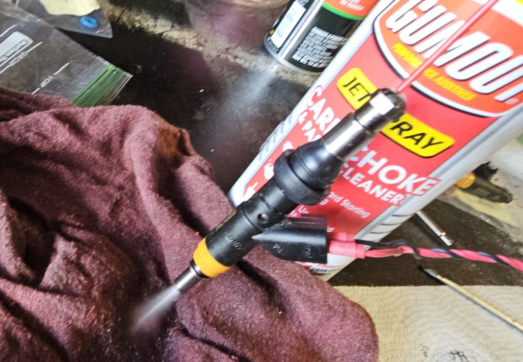

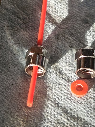

I found a nice metal valve stem, and drilled a small hole for the spray tube. Used Carb+Choke cleaner, and activated the injector with a 9v battery and pushbutton switch.
Before:
After:
Damn you went all fancy with the steel valve stem Ed,i might have to update mine now after seeing yours :waytogo: :Big Laugh:
The rubber valve stem and cap i've been using probably aren't as good as your set-up
I had the rubber valve stems, but saw the metal ones at O'Reilly's and thought, "That's neat."
Glad I can help you spend your money.... :Big Laugh:
The battery and switch setup is all from you, my friend. :waytogo:
