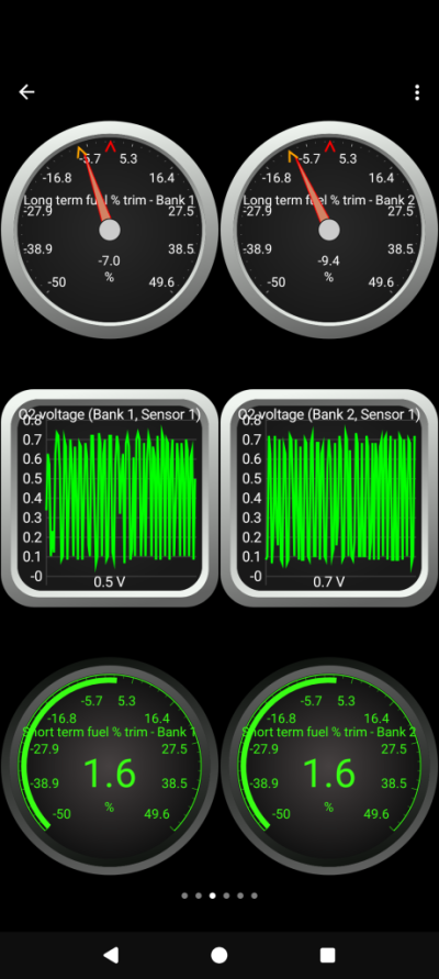

This is my current situation with LTFT, STFT and bank 1 and 2 sensor 1 operation.
STFT is bouncing back and forth between -3% and +3%. The LTFT did seem to level out some, it was -7.8 and -9.8 when I started the truck.
Maybe the charcoal canister is fuel soaked? It hasn't been topped off in several weeks. With KOEO, it's showing 30.1 inHg, which is standard sea level atmospheric pressure.
Intake temp sensor is working and reading normal ambient type temps or within 10 degrees.

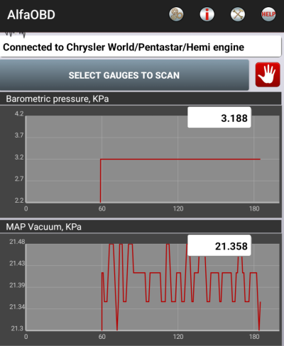

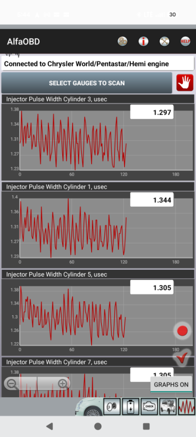

Double verified the purge valves. With the plug off and fuel tank side disconnected, not getting any vacuum through the purge valve. Even checked the old OEM one. So, kind of eliminates the purge valve as an issue. Also left the vacuum line off the purge valve off and connected to my vacuum gauge to verify actual engine vacuum at idle. Getting good results there and steady, not bouncing. Went to Alfaobd and check the trucks barometer reading compared to the MAP reading.
The 3.188 barometric pressure seems way low. I'm assuming that's what the actual atmospheric pressure should be?

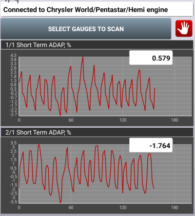

These are my short term trims.
My long term was stuck at like 12575 or something. Not sure what that's about. But if I go to the obdlink app and use their data, this is what it shows.

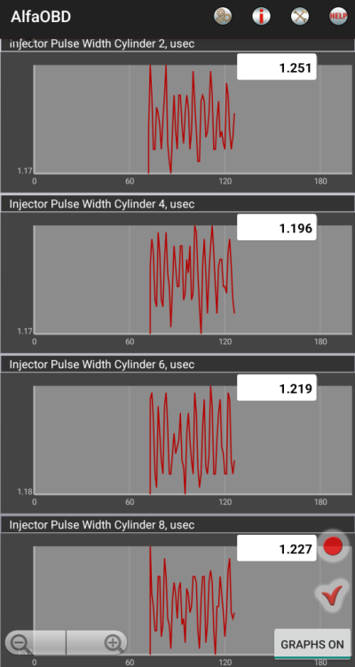

This is the injector pulse width for bank 1.
And bank 2 looks similar.
ONLY thing I can think of at this point is I have an injector(s) that is not leaking, but is slow to close. I guess the next step would be to ohm the injectors and see if there's some that are not consistent.

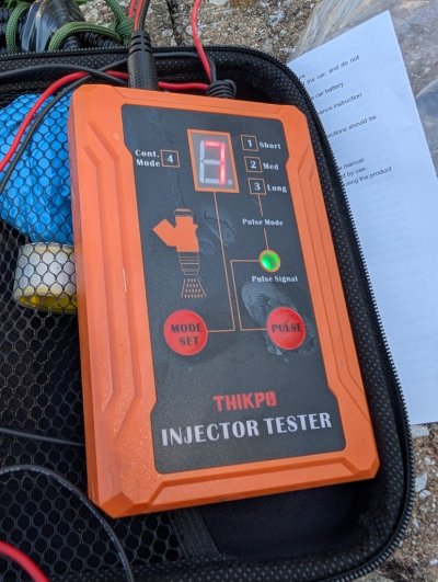

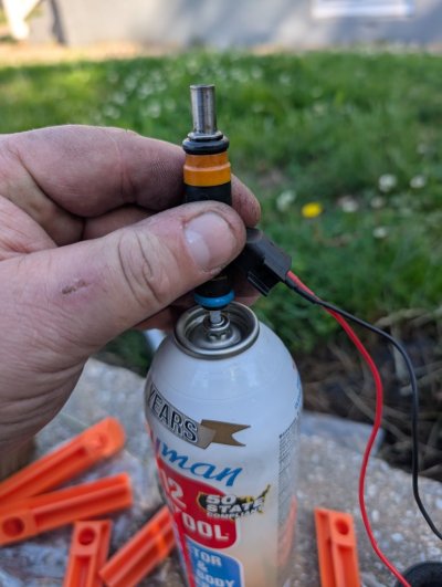

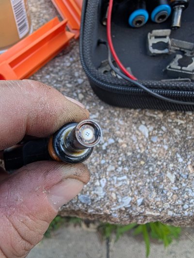

Pulled the fuel rail this morning to check the injectors and check the spray pattern and clean. Came home from work, ate breakfast real quick. Went outside and pulled the fuel pump fuse. Went to start the truck to bleed off fuel pressure. Truck barely wanted to fire. Tells me my test the other day where the fuel pressure bled off was accurate. So, pulled the rail and started using the contraption I bought. The tester works good. The adapter that adapts the injectors to the spray can, not so much. Luckily I found the hole in the back of the injector ended up making a pretty tight seal to the spray can nozzle and just pushed the injector to the nozzle and activated the tester. I was expecting the spray patterns to be wider. Some of the injectors were still pretty dirty, even after all the cleaners and me cleaning the bottom of the them when I pulled the manifold back in early April.
I actually have some reman'd injectors showing up today. Figured I'd go that route for now and I'll spend some time and clean these originals up really good and maybe see about rebuilding them. Worst case scenario, I can always put the originals back in if these reman'd ones start giving me fits. It's easy enough to do.
This tester was less than $25 on Amazon. Seems worth the money to me.
