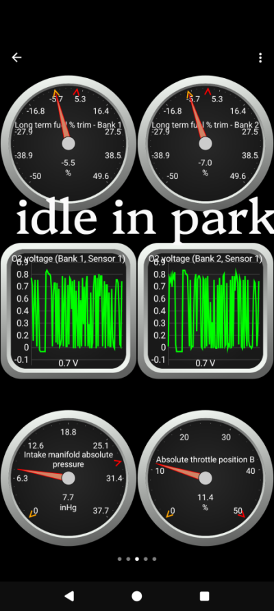

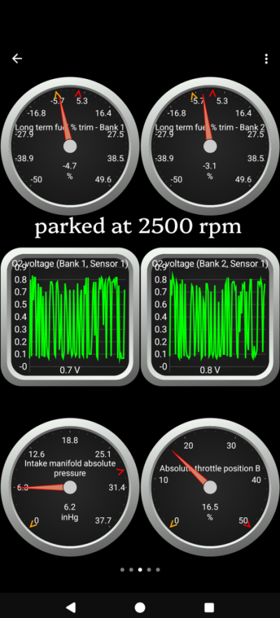

Took some screenshots of ltft at idle and at 2500 rpm.
I'm not seeing a massive discrepancy between bank 1 and bank 2. Certainly nothing +/-10% either while driving.

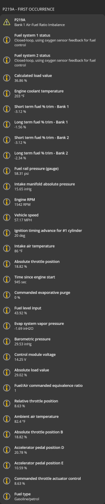

Well, code came back on my way home from work...
This is a screenshot of what was going on when the light was triggered.
