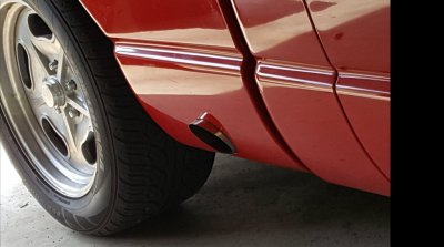

I use Pacesetter long tube and ory all 3" diameter. Thought I'd try true duals with cross connect out each side. It really hurt the low end and couldn't tune out the loss. Used a pair of aero 3030xl. Sucker was lou20160609_120117.jpg d. Pulled the true duals off and went back to the Y pipe and one aero 3030xl and low end power was back... my gas tank is relocated to were the spare was mounted..
