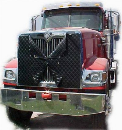

Semi trucks also have automatic grille shutters, but when it get really cold, they use specially design blanket pads
watch this video, it gives the drivers reasoning for the blankets
