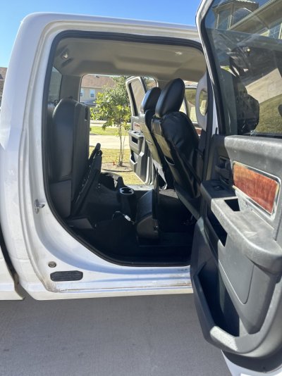

I recently upgraded my interior from a tradesman to a Laramie and when I had the carpet out I saw there was a factory wire for a subwoofer so naturally I grabbed one in the junk yard yesterday, I got it plugged in and there nothing coming out, wondering if it at a dead end or I need to look further into this. Thank you.

I’d imagine unless you have the Alpine or HK amplified system, there’s no signal being sent to the sub, or definitely not enough to push it

The subwoofer is powered from the amplifier in the 9 speaker Alpine sound system. If your truck came with the standard 6 speaker system, there is no amplifier.
You would be further ahead to go with an aftermarket subwoofer like the Kicker Hideaway and possibly upgrade the radio to something aftermarket with wireless AndroidAuto/CarPlay built in.

You want a sub the easiest way on a non factory sub truck is get a speaker signal to rca adapter (loc-2) and either run that into your amp or run it into a pre amp for more adjustability then from there to your actual amp. My truck came with a factory amp and I did the loc-2 rca off the sub feed then into two pre amps and then to my amps. It sounds deadly!
