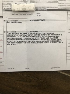

So washed out the fan/radiator assembly last night and the extreme shaking still occurred on a start up after. So just dropped it at the dealer now. Attached is the write up. They’re going to call me after they look at it.
I don’t like the way that reads at all. They look to have written “an out” just in the drop off notes. I bet you are wasting your time at this dealer. I think I would have went to a new one so there would not be any history there. Nevertheless assistance it will pay off with them honoring the warranty claim. @56PW17 had a issue with warranty but it worked out for him after a little back and forth. I had to use @RamCares to get my steering wheel replaced. I used to warranty for a tire sensor and for the front parking sensors with any issues.
it was hit or miss with my Ford Raptor as well. So it is not just a Ram warranty thing. Good luck and I hope you don’t have to cover the $1400 bill you are about to receive. ( just a guess)
They will be calling me first to discuss their findings. If they refuse to cover it i will just go down and pick it up and call FCA.

So the end result at the dealership was they cleaned mud out of the harmonic crank dampener and mechanical fan. They charged me a small fee for cleaning it, which is fine. However, they documented it in a fashion which will allow them to say future issues could be a result of mud. They said they will not cover damages from mud or dirt or water even though RAM advertises the Power Wagon can traverse through up to 30 inches of muddy water and be covered under warranty. I called FCA customer service who stated the dealership is correct and any damage caused by mud, dirt or water wont be covered under any warranty and had no answer for me when I confronted them with their advertisement. I feel like RAM should design these components not to be so vulnerable to mud and dirt on this truck.
So if it got in the Harmonic crank dampener then you were pushing 38-40 inches. Maybe even 42” of water. FCA may have a leg to stand on.
I am glad you are back in your truck with out much delay.

So the cleaning fixed the issue?
I mean, if it was truly caused by just the mud then it is what it is...cant really blame that on fca. Could the harmonic balancer be made differently for that not to happen?

The mud was splashed into the engine bay while traversing through the mud. The depth was no where close to 30 inches.
Cleaning it revolved the issue it seems and I’m fine with paying the cost of cleaning. The take away for me is muddy water must be traversed at very slow speeds. Unlike my last truck, there is no skid plate running from the bumper chin down to the top of the front axle. This prevented mud splatter from shooting up directly onto those components. When I would clean out the engine bay of my old truck, I would notice the face of the engine (where the belt is) and fan assembly was relatively clean but the sides of the engine bay would be very muddy. This was even the case after one trip where we traversed a little over 2 feet of muddy water.

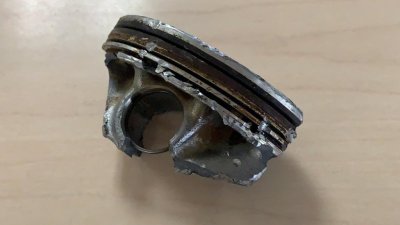

Gotcha, the picture was a bit pixelated and I didn’t zoom in. As someone who (very recently) hydrolocked their engine with a splash very similar to the one posted, I can’t stress enough, approach water SLOWLY. I understand the temptation to make a big splash and have mud and water go everywhere, that’s what I was doing (someone with very pretty eyes sitting in my passenger seat may have been egging me on lol). But I was third in line of a group of a dozen vehicles who all got to see my truck go kaboom.
This is what was left of the piston that went through the block, and was the largest piece they were able to pull out. The hole in the block was the size of a softball. Water is no joke, and I’ve already installed a snorkel because that was the SECOND time I hydro’d the same engine, so since I obviously can’t learn from my mistakes, I can at least protect myself from myself lol and I am keeping that piston head in my cup holder as a reminder to not do dumb ****. I can only push my insurance company so far!
