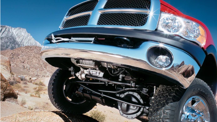

Pretty sure that was Power Wagon only. That's why you never saw a PW with the sport bumper; had to have enough room for the tow hooks and winch.
Screenshot 2022-10-21 at 18-04-37 The 2005-2009 Ram 2500 Power Wagon Nobody Knows About.png

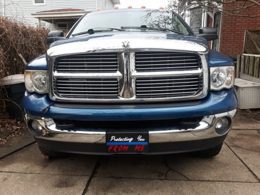

I think that would work on my truck., Except I have an intercooler, a condenser, and a trans cooler that might be in the way.

Nah, look at that picture again; it's underneath. All that stuff is directly behind the grille.
