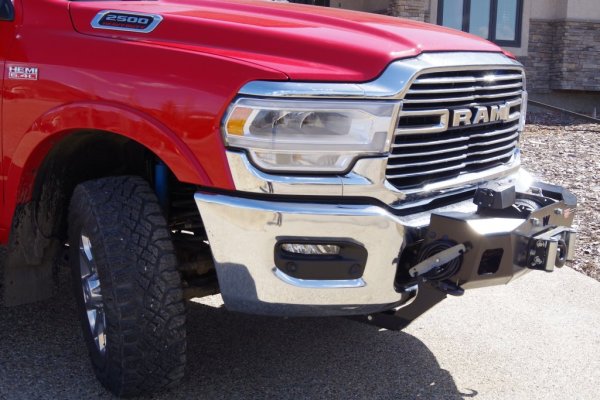

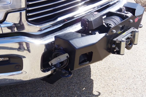

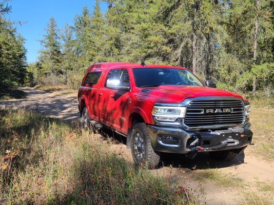

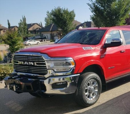

Warn 16,500 TI in a warn transformer mount on a 2021 Ram 2500. Top picture was the Warn, I had a Champion 16,000 on it for one year when I first bought the pickup; you can see in the next pictures. Got rid of it because it was impossible to pull it out in free spool, and it had very slow line speed under power. The Warn is more money but a FAR better winch. I only took the Champion because in 2021 the were no large Warn winches available. Luckily, my accessory guy is a great fellow and gave me full credit on the Champion against the price of the Warn.

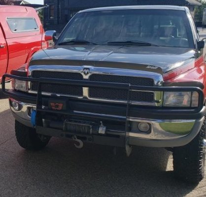

29 year old 10,000 Lb Warn on a 1996 2500 V10. Used it a ton, never a lick of problems. This pickup weighs just over 8,000 Lbs rigged to hunt, so this winch got snatch blocked a LOT. It is why I put the 16,500 pound version on the replacement pickup.
