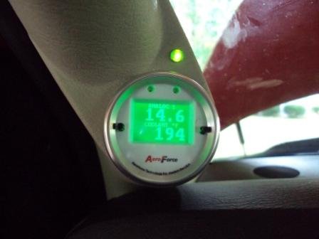

It's a complete package. The only thing I added was a indicator. $2 led from radio shack.
