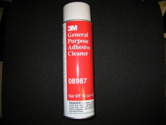

3M Adhesive Remover

Well, I ended up doing the following method to remove all the adhesive tape off the fender flares....
1) carefully take a razor blade along the tape to remove as much as possible.
2) spray remaining tape with adhesive remover.
3) use a flat plastic trim removal tool to scrap off rest of adhesive.
4) repeat steps 2 and 3 as needed until clean.
5) wash fender flares to remove adhesive remover residue.
That's it for now, letting them dry and will get new tape to install them on my truck.
