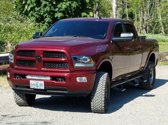

On my 2014 I purchased the Bushwacker pocket flares. I did use the 3M Clear Bra material and the flares come with a nice vinyl press in seal that goes between the body & the flare.
Those flares are formed and sealed but the center is hollow. The backside is fully enclosed and I saw no gaps between the fender and the flare when they were installed. They are rigid enough not to move around and the wall material is heavy enough that they won't deform and pull away from the body of the truck.
The biggest variable I can see that can cause material to get in between the body and flare is the quality of the installation, not the quality of the Bushwacker flare.
This is the 2014:

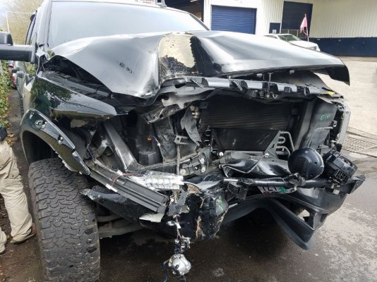

I never got a chance to check out the body where the flares were installed as that truck came to a bad end:
But look at the flare on the passenger side fender. It's still stuck in place even being as bent as it is. I think it sealed pretty good.

Looks like they didn't save the front of your truck from whatever hit it. Geez man!

Believe it or not, that poor black truck looked a lot better than the other truck...and it still ran!
