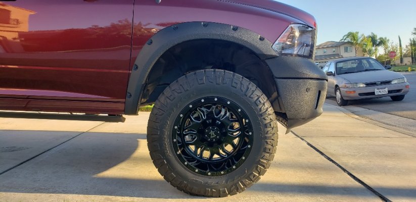

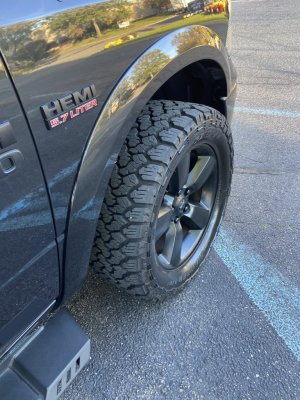

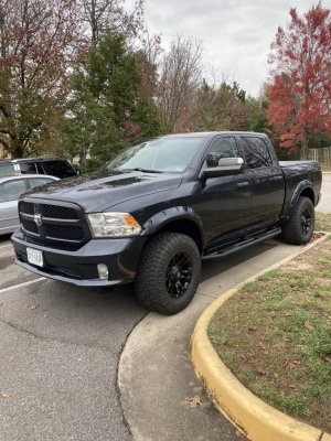

I put the bushwhacker on mine & had to move the hemi badge about 1”, recently decided to remove

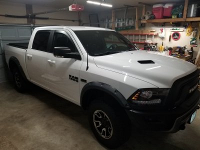

With the Bushwacker pocket flares most people reported they have to move the Hemi emblem.
For some reason, mine just fit without moving it.
I have an '18 2500 classic. Same bushwhackers, didn't have to move anything either. I think QC on Hemi placement isn't the best, and unfortunately you won't know if you'll have to move yours until you buy some and see the fitment, or take some really good measurements. Good luck!
