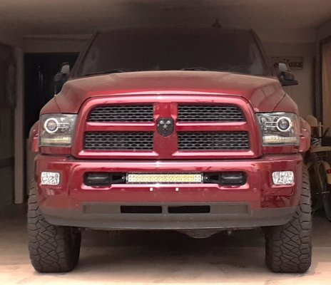

2017 2500, 17x8.5" +18 offset wheels, 35x12.50/R17 Nitto tires.
A +12 offset would have worked as well.

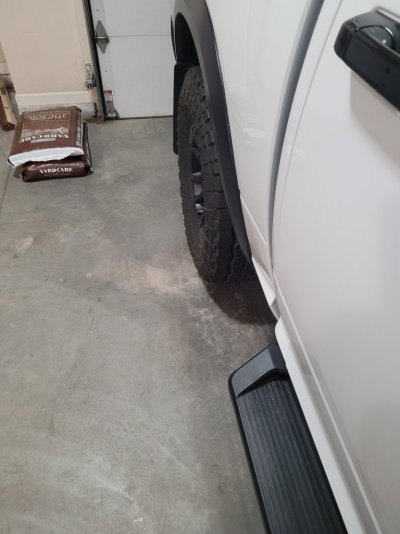

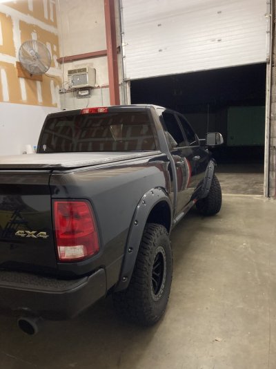

My old set of wheels were 18x9 +1 offset/ 35x12.5 Nitto’s, ended up needing 1” spacers, tires hitting uca’s at full lock.
My current set is 17x9” with a -12 offset/ 35x12.5 MT’s & have no rubs, no spacers.
My tires sit right a the edge of the flares.

This is the exact look I'm going for on my 2015 2500. Did you lift, or just level? Did you have to do any trimming to prevent rubbing? Thanks!
No trimming was needed with that tire size, wheel offset and a 2.5" level kit.
