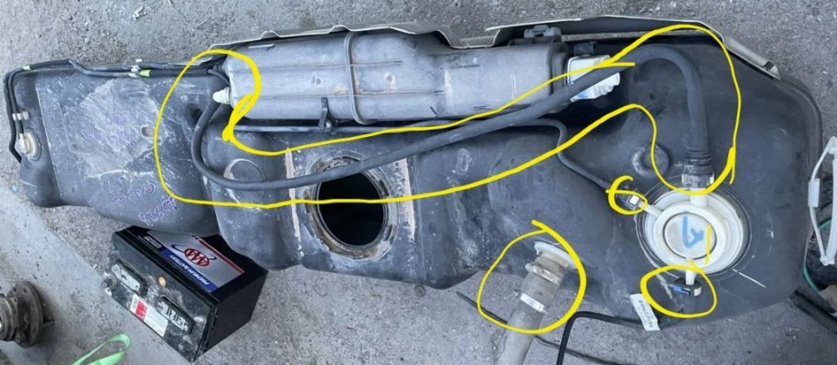

Had you cleared the codes and lights BEFORE the road tests? You should of to see if they come back.
If you did then you'll have to go further and look for cracked hoses or even if a mouse had chewed through a plastic line. (I've had that happen to a customer)
Below is an example of the hoses to check. Most shops would check it with a smoke machine and may show what you cannot easily see so best of luck.

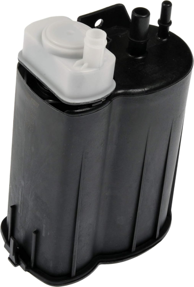

down on the charcoal canister, there is a ESIM
It would be the 3rd thing to check.
you will find it on this, at the back of the fuel tank
